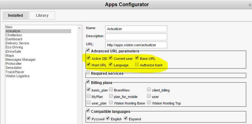

Hi Spev
Thanks for the reply. Can you share in which area of the app configurator i should add my custom parameters. I have attached the app configurator screen shot.

prabhu.janakiraman, as for additional custom parameters - You can pass them to app.
Just set app URL in CMS Manager with Your parameters, for example:
http://my-dns.com/myapp.html?test=123&param2=ok
