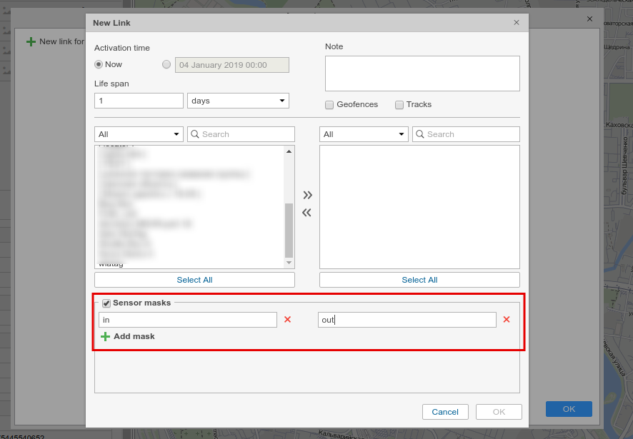

We have a Locator tool for users who are not allowed to use cms / hosting. There is an ability to see sensor values there, not raw parameters. You can create some sensors with appropriate parameters, e.g. create a sensor with parameter in and get the decimal sum of all inputs or a separate sensor for each parameter.
The idea of an app for technicians is good, but there are no enough problems for a new solution from your descriptions. All examples may be solved by current functions without difficulties I see.

That is why I recommend to use Locator, as it doesn't give any unnecessary access and let to see sensor values and coordinates. See the screenshot.
