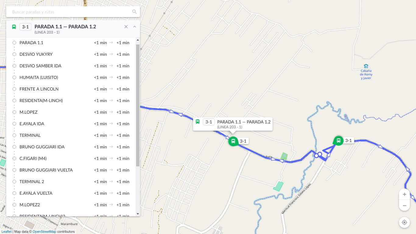

Can you please indicate how to get the route associated with a unit through the JS SDK?
I need to replicate the information that you see in the screenshot in a mobile application

Hello!
1. You can find all documentation about Nimbus API (REST requests) here
2. In order to your screenshot if you need to get Stops you can execute request 'Get all the stops of the depot'
3. For Nimbus app there is not JS SDK, only REST API

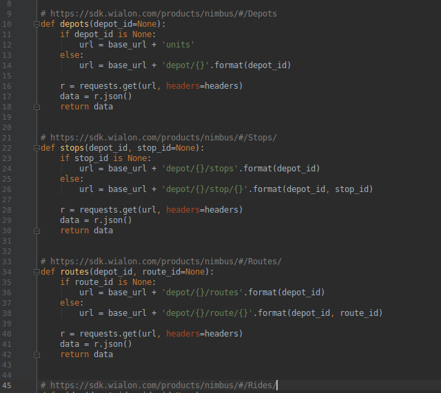

After spending some time testing the nimbus API, I be able finally to draw the route on the map.
Now I have another problem, I want to be able to move the units across the map.
Could someone tell me how to get a list of units with their respective positions (with Nimbus API), to be able to show on a map the movement of them?

Thank you very much for the help, I'm getting the positions through the Wialon API and now I can continue with the development of the app.
Regards!
