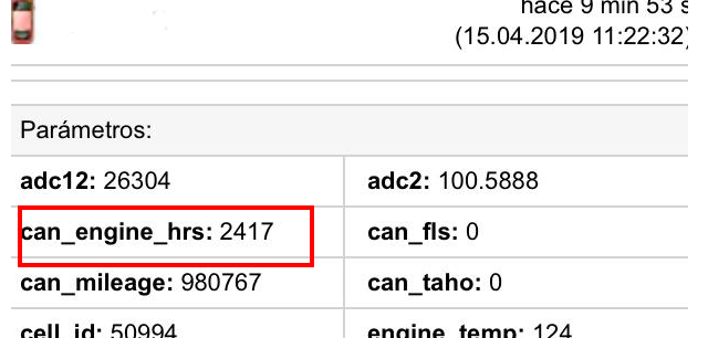

Hi, I'm having trouble getting the sensor value "can_engine_hrs".

Reading in the forum, I saw that they gave a page of ejmplo. OK, I change the values that I use, but it gives me a value that does not match my sensor values.
PAGE: https://sdk.telepuls.ru/playground/nd2rz2kG/2
RESULT:
 sensor values: [
  "3": -348201.3876
On the platform of wialon gives me the following value: can_engine_hrs: 2430
What am I failing ?
  • Problems to get the sensor value in Node.js
Re: Problems to get the sensor value in Node.js
Hello!
1. Error 4 -  it's not correct name for parameter source. Please check, you type '"souce":"" . Just slip of the pen.
2. Example of code https://sdk.telepuls.ru/playground/nd2rz2kG/2 - you specify unit ID (test unit) which doesn't have parameter  can_engine_hrs and it's sensor with id = 3 doesn't have value (unknown value is the same as -348201.3876)
You need to work with your unit, specify it's id
