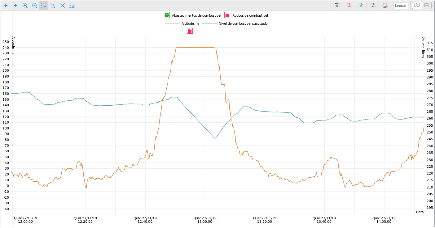

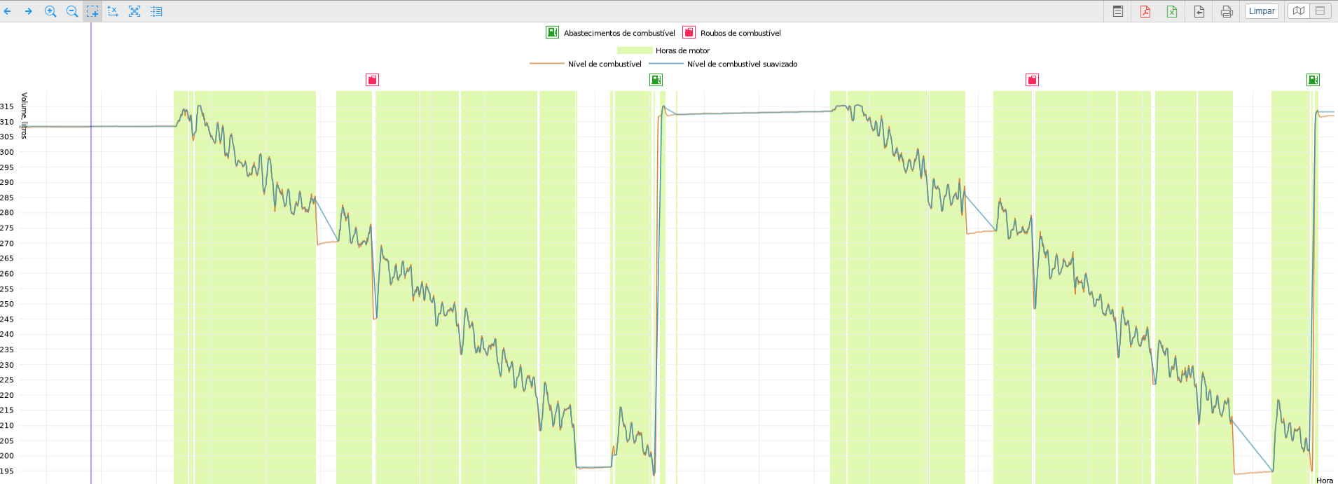

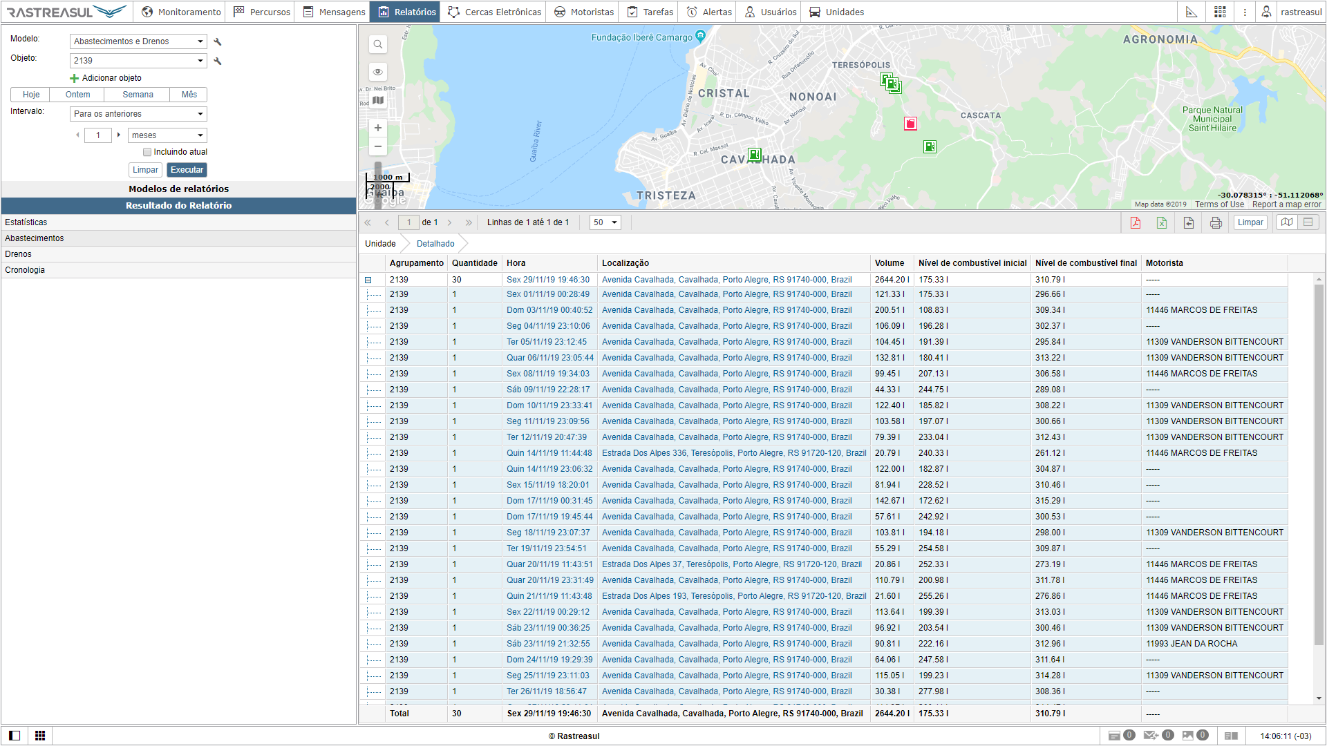

In other platform we use there is a possibility to delete fuel fillings and fuel thefts. The reason is simple: vehicles often go up and down hills and the sensor identifies a variation in fuel level. This causes the system to detect a false fuel filling/theft.
In the screenshots (fuel x altitude) I'm sending you can see an example.
If you can't delete these events, the values of the fuel consumption/filled are going to be very wrong, so I'd like to suggest the implementation of this tool.

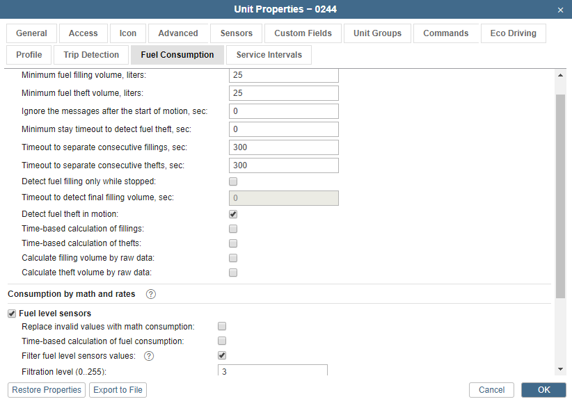

Which filtering data events do you recommend me for using? In both platforms I'm having this issue, but in Omnicomm I can manage by deleting the false events of filling/theft.
I've tried changing but it didn't solve our problem, the only one that could solve was by changing the minimum filling/theft volume, but if I adjust this with a higher value, we are going to have other problems like not detecting the real fillings/thefts.

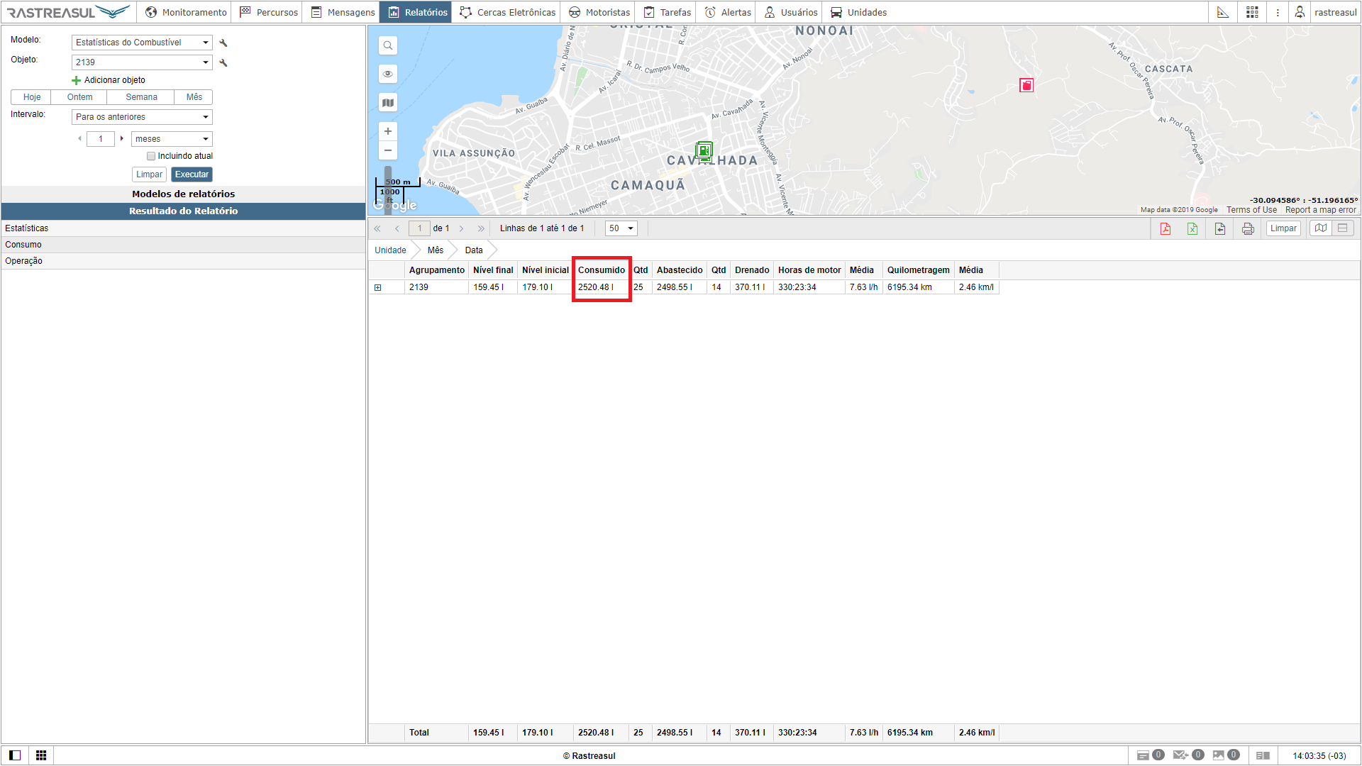

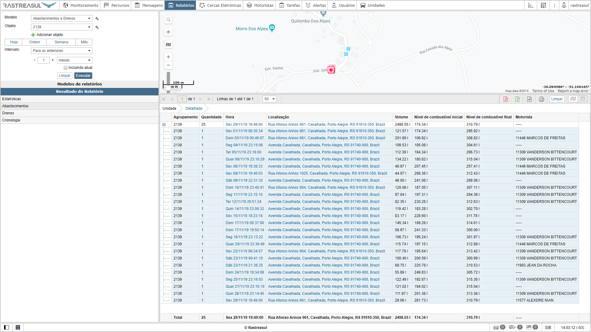

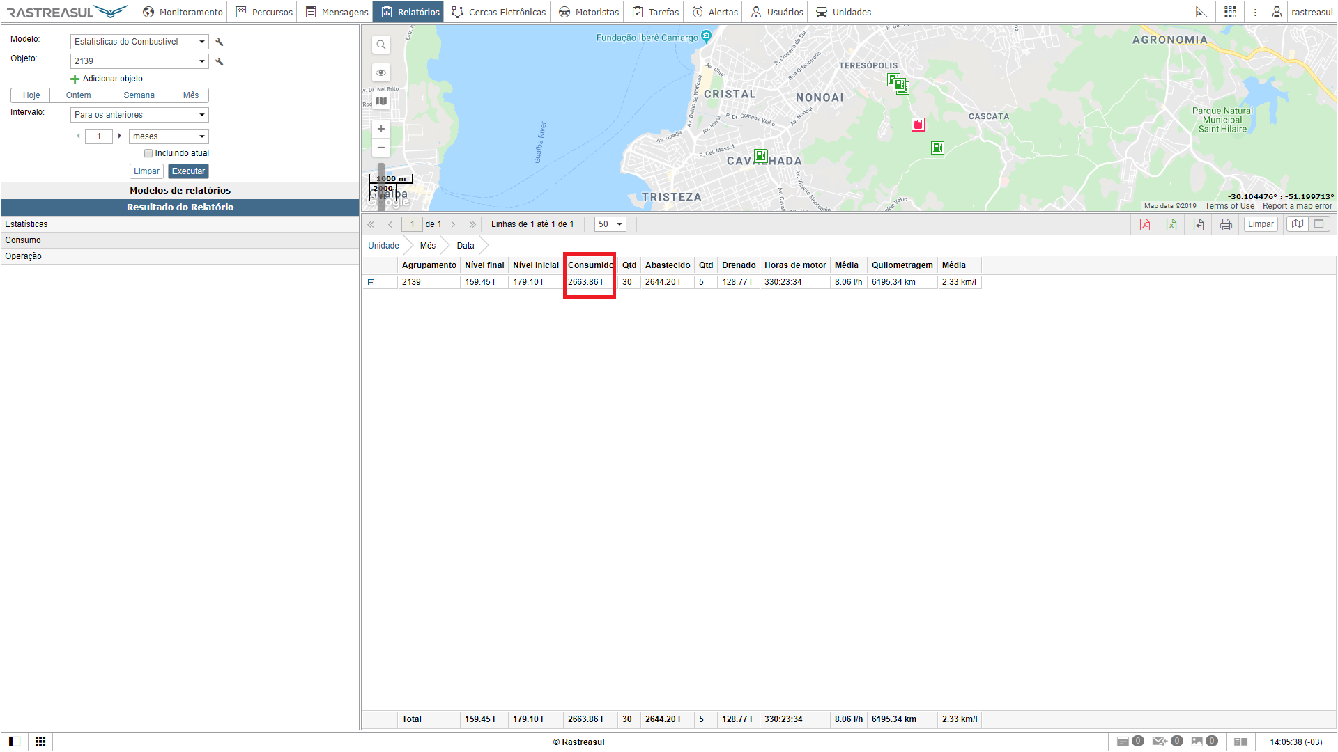

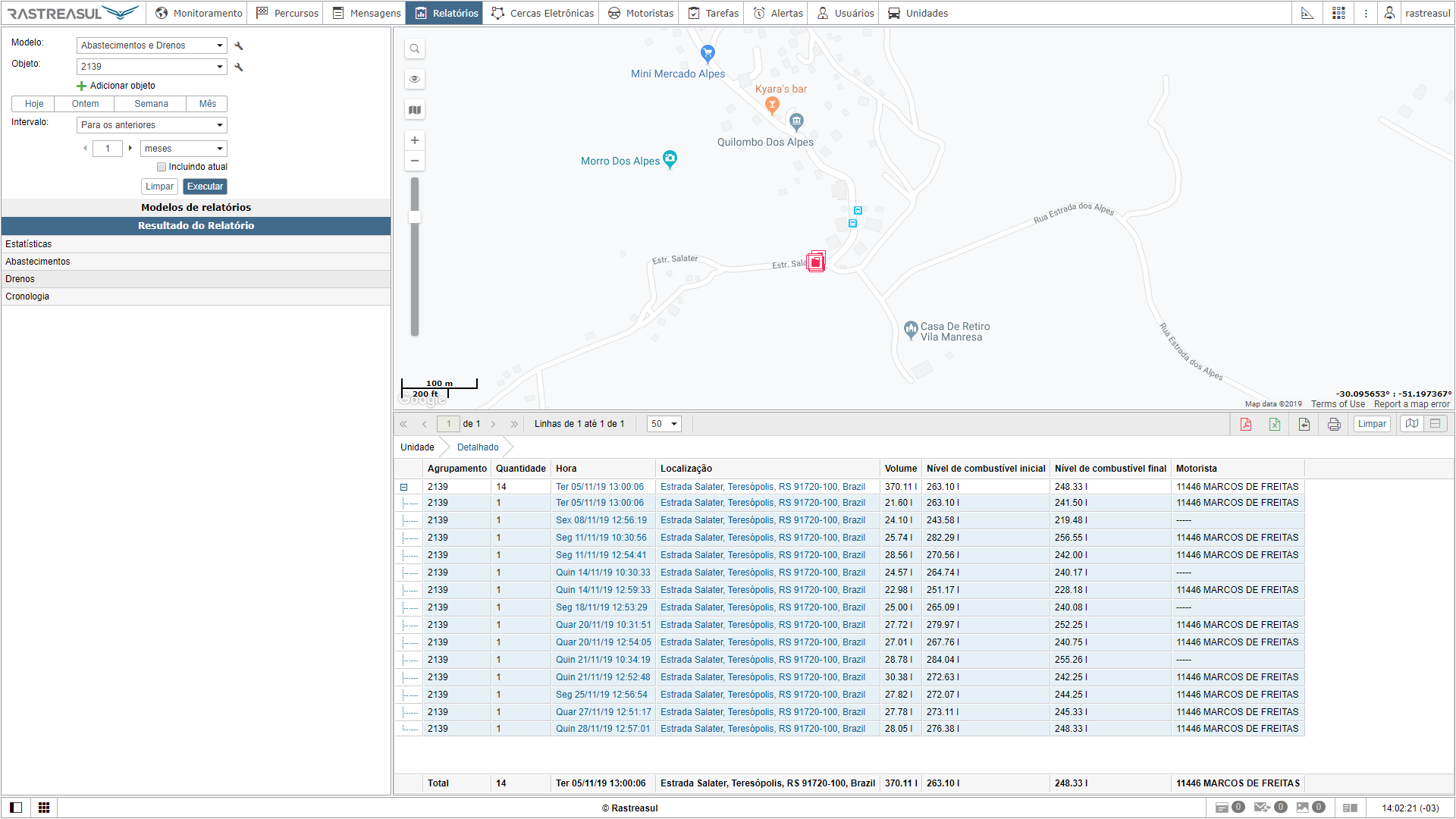

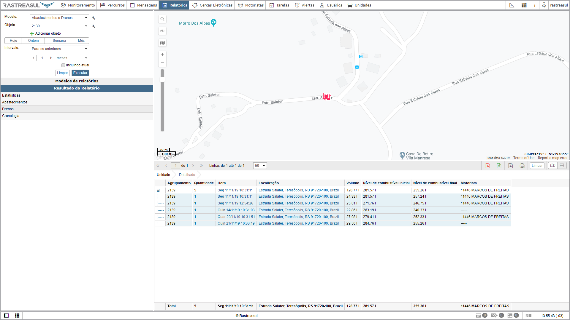

I'm sending screenshots of the results.
It helped a lot but didn't solve completly the problem (thefts reduced from 14 to 5 and 5 fillings were reduced, but should be only 4). We live in a place where there is a lot of hills and the vehicles are always going up and down, so I think that the only way to really solve this problem is implementing the tools I wrote before.
Thanks!
Screenshots:
First: without your configurations
Second: with your configurations
1: Fillings
2: Consumed
3: Thefts

also make filtration 10 or 15

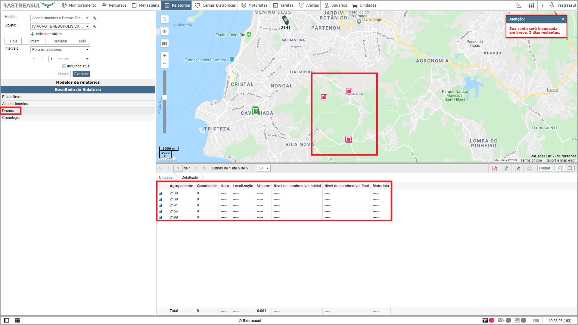

Hello hasan.ahmed,
I did more tests and it worked with geofences, It's an alternative we can use for now.
Although this solves the problem with fillings and thefts, it doesn't solve with fuel consumption and there is also an a particularity: the icons of fillings and thefts still appears on the map because it is based on the sensors (screenshot).

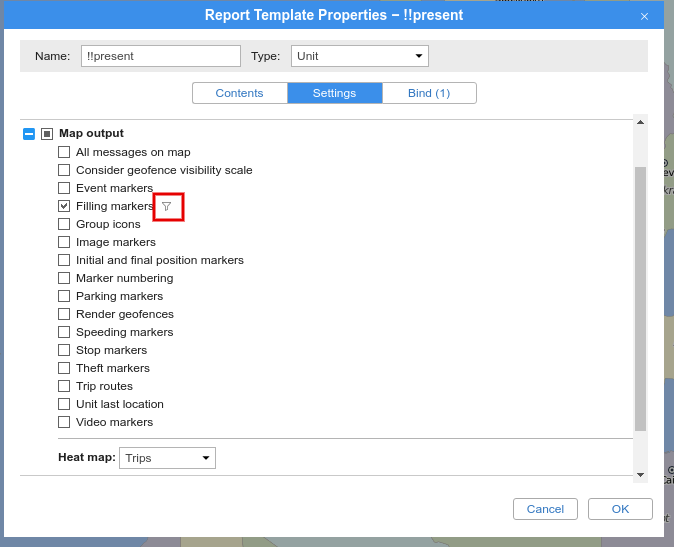

You can use filtration for markers also (see the attached file).
Also, I should notice that there is no possibility to delete data in a report. Reports are based on calculated raw data. Every time you request the report it generates from the beginning. Any interval is not a particular element that may be corrected or deleted. You may correct only raw data, that will affect the report data.

Hello tata,
Thank you, I didn't know that there was filters for the markers too.
