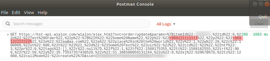

i have attached the postman message i just removed the sid and account id
  • Create Order API
Create Order API
Re: Create Order API
Your params are ok, everything works.
The issue is with '+' sign in phone number, it must be encoded but Postman skip it in GET method (see screenshot)
Wialon Remote API should be used with POST method (see docs), it solves the issue.

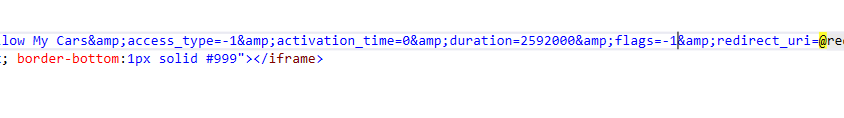

thanks to hhamedk i fixed the parameters error now am getting error 7 access denied is there any permission i should set for the account to enable the api to make orders ?
Create Order API
1) Check your token access_flag, 0x800 is needed.
2) Check user access to resource with "Account ID", "Create, edit, and delete orders" is needed
Create Order API
am using the iframe login and set the access type and flags to -1 which should be unlimited access
  • Create Order API
Create Order API
mfathy, simply check if the account your are using for API has access to Logistics on web version and if it works fine or not. If No, then the problem is related to access of account.
