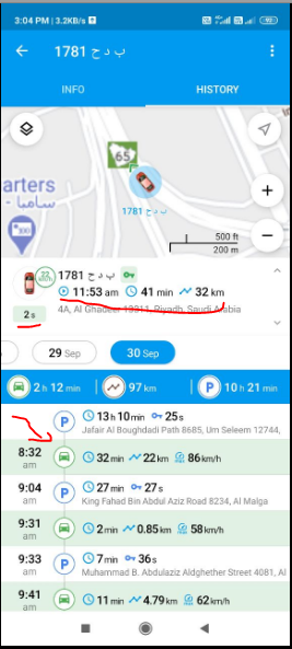

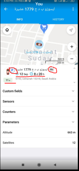

Hello Team
How i can get the attached screenshot details from the item search API
http://gps.tawasolmap.com/wialon/ajax.h … mp;params= {"id":20646,"flags":4611686018427387903}&sid=96d4c9e77d385ddf775f64d3c5dbd85b
As i have thought as per below please correct me if i am wrong
1) Name of the Unit                    items[0][nm]
2)Unit id                                      items[0][id]
3)Unit Latitude                            items[0][pos][x]
4)Unit Longtude                        items[0][pos][y]
) Speed of the Unit                     items[0][pos][s]
Date of last active
Engine status (On/Off)
Unit is in the parking or not
Last speed
How i can get from the above API if you
  • How to get Unit Last update date and time
Re: How to get Unit Last update date and time
Hello!
1) Last data information (unit name, speed, position, date/time) you can get via request search item (or search items ) with correspodings flags value.
2) Engine status , moving/parking status you can get via Events - trips and igntion
To get live events the steps are the following
  • Then execute request events/check_updates, for example every 2-5 sec, to get response with online data
For example
1. First (after login) it needs to add required units to session via request  svc=events/update_units
https://hst-api.telepuls.ru/wialon/ajax.html?svc=events/update_units&params={"mode":"add","units":[{"id":2147,"detect":{"ignition":0,"trips":0}},{"id":2174,"detect":{"ignition":0,"trips":0}}]}&sid=023078baa1999df1ea0da05cd4cbc9a02cb
"units" - units array where  'id' - unit's id, 'detect' - required events types, in our case only "ignition":0 and trips "trips":0, 0 means all ignition sensors, if you know that unit has only 1 ignition sensor, you can set up '0'.
If there is several ignition sensors it's better to set up sensor's id. But sure it depends on appropriate business task. For trips is always 0 ("trips":0).
It needs to specify for each units 'id' each 'detect' type.
2. After required units has been added to session, we can monitor online ingtion state via request events/check_updates which can be executed for example every 2 sec or rarely , it depends on how often the device sends data to the server
https://hst-api.telepuls.ru/wialon/ajax.html?svc=events/check_updates&params={"detalization":3}&sid=023078baa1999df1ea0da05cd4cbc9a02cb
"detalization":3  means that server will return  JSON information for flags plus
Thanks for your support
as I got below response with once I follow the above steps 1 and 2 and below response I got
I got ignition and trip array,
how I can get value under the unit image "11s"
Date and time with speed
All the movement of the unit on the selected date

Hello!
You can get  "avg_speed" speed parameter, or "curr_speed": - current speed, parameter "m" shows the time of last message (Unix time UTC+0), the trip duration is calculated as difference between "from" and "to"

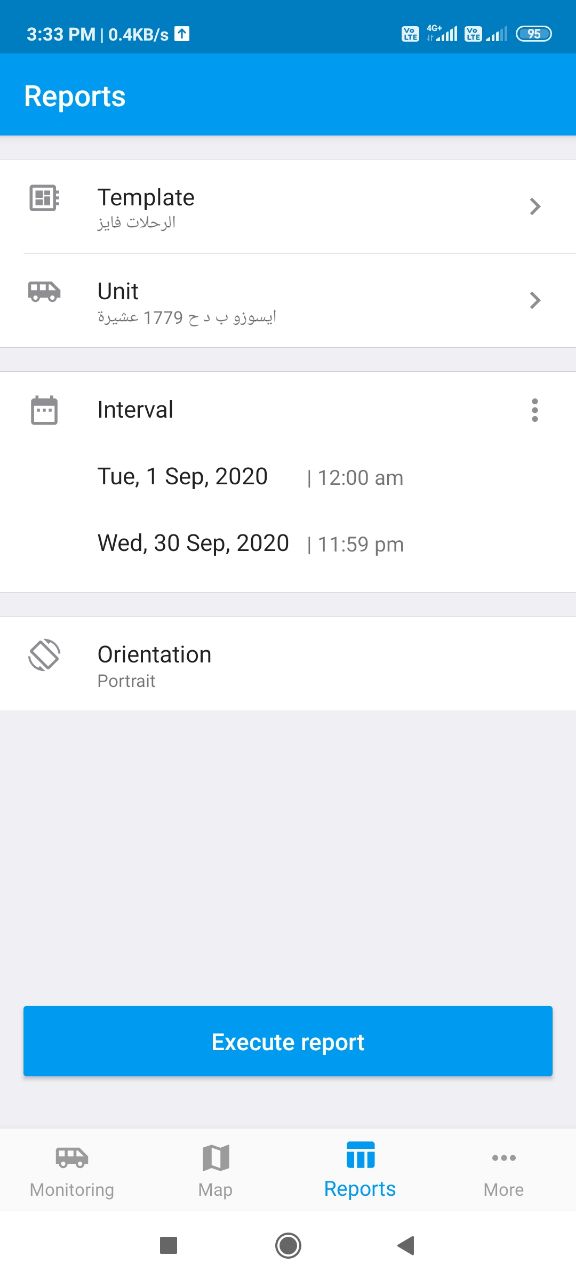

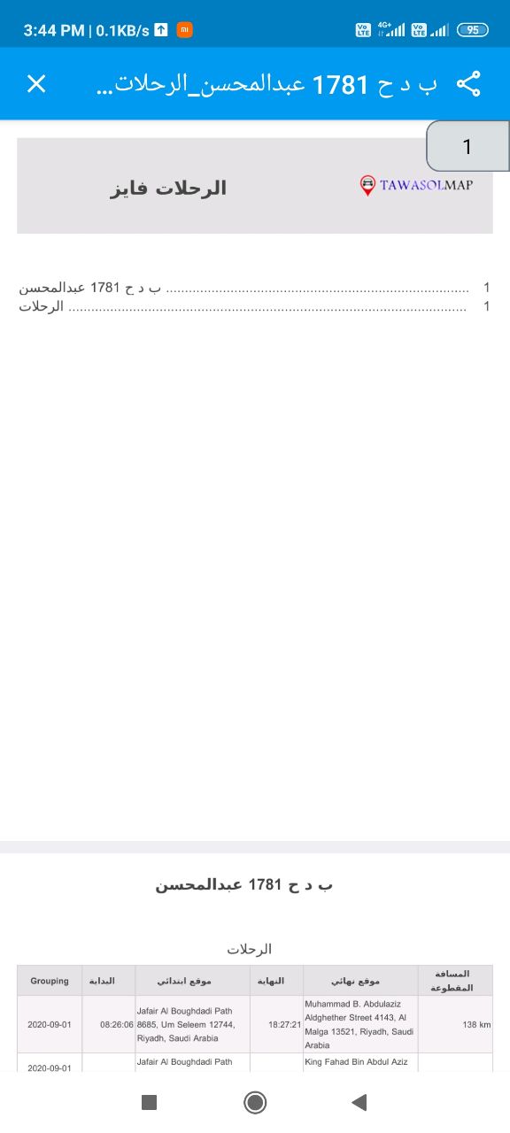

Hi, thanks for the update
If you can please help me how i can get the report pdf file of the units same wialon App
1) Which API we can integrate to get all template to belong to the account
2) which API should help me to execute the report of the unit and in response get a pdf file with details of the movement with address
Please check I have attached two files
Hello!
1) To get all reports created in account via request search items or
search item by ID  with flags = 8193 ( base flag + 8192 reports data)
2) To execute report - please look example  https://sdk.telepuls.ru/wiki/en/sidebar/ … es/reports
3) After report executed you can export it to file - please look the request format here https://sdk.telepuls.ru/wiki/en/sidebar/ … ort_result

Thanks for the reply
i do execute each but in the last export report getting an error
http://gps.tawasolmap.com/wialon/ajax.html?svc=core/search_items&params={"spec":{"itemsType":"avl_resource","propName":"sys_user_creator","propValueMask":"*","sortType":"sys_name","propType":"creatortree"},"force":1,"flags":8192,"from":0,"to":1000}}],"flags":0}&sid=17c6be7cb59c41cdf2996f20b18ac2b7
Got success
http://gps.tawasolmap.com/wialon/ajax.html?svc=report/exec_report&params={"reportResourceId":55874,"reportTemplateId":10,"reportObjectId":20646,"reportObjectSecId":0,"interval":{"from":1601449803,"to":1601877534,"flags":0}}&sid=17c6be7cb59c41cdf2996f20b18ac2b7
Got success
http://gps.tawasolmap.com/wialon/ajax.html?svc=report/export_result&params={"format":2,"pageOrientation":portrait,"pageSize":a4,"pageWidth":0,"coding":utf8,"delimiter":semicolon,"headings":0,"compress":1,"attachMap":0,"extendBounds":0,"hideMapBasis":0,"outputFileName":"Online_report"}&sid=17c6be7cb59c41cdf2996f20b18ac2b7
getting error in last API
    "error": 4,
    "reason": "WRONG_PARAMS"
Hello!
There is not quotes for text parameters, like "pageOrientation":portrait, "coding":utf8 and etc.
the correct params
{"format":2,"pageOrientation":"portrait","pageSize":"a4","pageWidth":0,"coding":"utf8","delimiter":"semicolon","headings":0,"compress":1,"attachMap":0,"extendBounds":0,"hideMapBasis":0,"outputFileName":"Online_report"}
(21/10/2020 13:40:35 отредактировано trushal.shah)
Hello Thanks for the reply
As its works but still that i need to display in a PDF file to the user

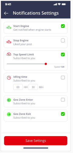

Hello Gurtam team
I stuck with at below APi request that my client request to  notification send to login user users as their engine is on, engine off, speed limit and geozone
How i can set notification with specific units
like
1)Unit engine is on and get mobile notifications
2)Unit engine is Off and get mobile notifications
3) Unit is running more then set speed
next is get all notification of the units same as current attached screenshots
http://gps.tawasolmap.com/wialon/ajax.html?svc=resource/get_notification_data&params={"itemId":55874,"col":]}&sid=c59a1d9fe2a4927c94d540dd190b6956
Hello!
As I understand you need to create the following notifications with required parameters:
1) Control engine is on, action  - get mobile notifications
If unit has Engine Ignition sensor, you can create notification to control sensor by type = Engine Ignition Sensor ("engine operation")
Use the following parameters:
{"n":"example engine On","ta":1603746000,"td":0,"tz":134228528,"la":"en","ma":0,"sch":{"f1":0,"f2":0,"t1":0,"t2":0,"m":0,"y":0,"w":0,"fl":0},"ctrl_sch":{"f1":0,"f2":0,"t1":0,"t2":0,"m":0,"y":0,"w":0,"fl":0},"un":[1326],"trg":{"t":"sensor_value","p":{"sensor_type":"engine operation","sensor_name_mask":"*","lower_bound":1,"upper_bound":1,"prev_msg_diff":0,"merge":1,"type":0}},"d":"","act":[{"t":"mobile_apps","p":{"apps":"{\"Wialon\":[1027]}"}}],"txt":" notification text","fl":0,"mast":0,"mpst":0,"cdt":0,"mmtd":3600,"cp":3600,"id":28,"itemId":930849,"callMode":"update"}
2) Control engine is Off, action  - get mobile notifications
The same parameters as above, just change value range to 0 - "lower_bound":0,"upper_bound":0
3) Speed limit (the action as above)
{"n":"example1","ta":1603746000,"td":0,"tz":134228528,"la":"en","ma":0,"sch":{"f1":0,"f2":0,"t1":0,"t2":0,"m":0,"y":0,"w":0,"fl":0},"ctrl_sch":{"f1":0,"f2":0,"t1":0,"t2":0,"m":0,"y":0,"w":0,"fl":0},"un":[826],"trg":{"t":"speed","p":{"sensor_type":"","sensor_name_mask":"","lower_bound":0,"upper_bound":0,"merge":0,"min_speed":0,"max_speed":60,"driver":0}},"d":"","act":[{"t":"mobile_apps","p":{"apps":"{\"Wialon\":[1427]}"}}],"txt":" notification text","fl":0,"mast":0,"mpst":0,"cdt":0,"mmtd":3600,"cp":3600,"id":28,"itemId":849,"callMode":"update"}
where "min_speed":0,"max_speed":60 is allowed range.
4) Geofences control - in geofence ("type":0)
{"n":"example geo","ta":1603746000,"td":0,"tz":134228528,"la":"en","ma":0,"sch":{"f1":0,"f2":0,"t1":0,"t2":0,"m":0,"y":0,"w":0,"fl":0},"ctrl_sch":{"f1":0,"f2":0,"t1":0,"t2":0,"m":0,"y":0,"w":0,"fl":0},"un":[1186],"trg":{"t":"geozone","p":{"sensor_type":"","sensor_name_mask":"","lower_bound":0,"upper_bound":0,"merge":0,"geozone_ids":"930849_40:1595402237","geozone_id":"930849_40:1595402237","type":0,"min_speed":0,"max_speed":0,"lo":"OR"}},"d":"","act":[{"t":"mobile_apps","p":{"apps":"{\"Wialon\":[1427]}"}}],"txt":"%UNIT% arrived to %ZONE%. At %POS_TIME% it moved with speed %SPEED% near '%LOCATION%'.","fl":0,"mast":0,"mpst":0,"cdt":0,"mmtd":3600,"cp":3600,"id":28,"itemId":949,"callMode":"update"}
5) To get all notification with their params
Use the request resource/get_notification_data , the empty "col":"" returns all notifications

Hello Team,

Hello, Team Thanks for the Replay,
Before I call this API, Which API should i need to call to set that this login customer would get push notifications, like that
like Customer ABCD login with the application after authentication success, there are three Units associate with customer
1. BMW
2. Audi
3. Toyota
Now customers want to set a notification on each unit start. stop and speed that I will use your example API,
But my query is how that customer will get push notification in his Device- the phone  is there an API call for that to get notification
If you can please help in this also that how Notifications would work, like steps
Hello!
To send mobile notification (push-notification) there is not API, because the action is executed from back-end side in Wialon.
For this it needs to activate the corresponding action in notifications settings - Send mobile notification
or you can don't use the our functional, but realize something on your side.

I just want to know  about engine status On/Off
Case1: Speed is greater then zero  then Engine is ON
Case 2" Speed is equal to zero then
Speed 0 then engine off but some time speed is zero but engine status looks ON in the wialon Application
so which field should i consider for the engine status

Hello trushal.shah  !
You need to consider parameter "state"
"state" = 1 means ignition is ON when sensor is digital (so device sends 1 or 0 values, or ignition sensor has calculation table to get 1 or 0 values)
In your case I see the value  is , it means that Ignition is On (no zero value is ON also), but it's better to set up calculation table for sensor
Please note if we talk about history data (events/load/get) in this case the system always return intervals where Ignition is On ,parameter 'state' is not zero (like in report table Engine hours)
