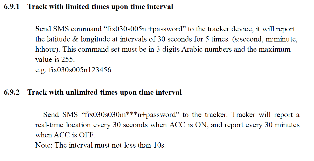

Hello
see attached pics for the SMS command to use
regards
Thanks, I'll report back soon about this.
