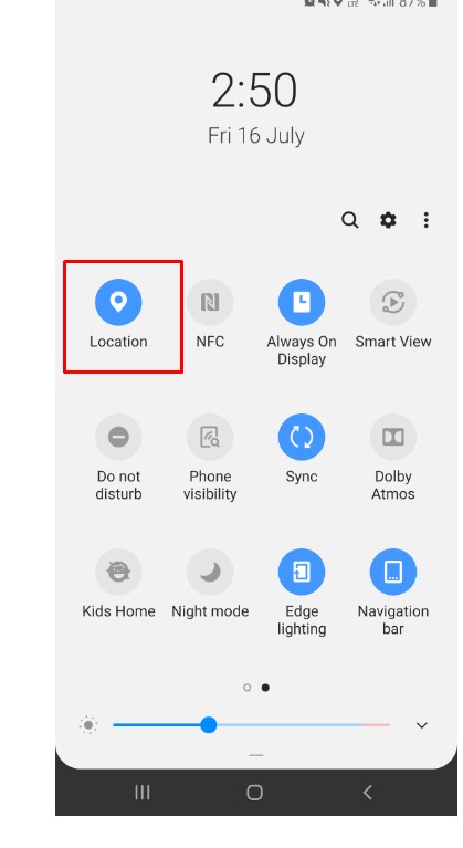

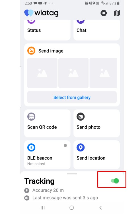

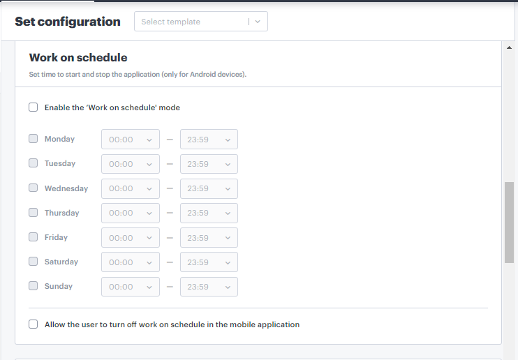

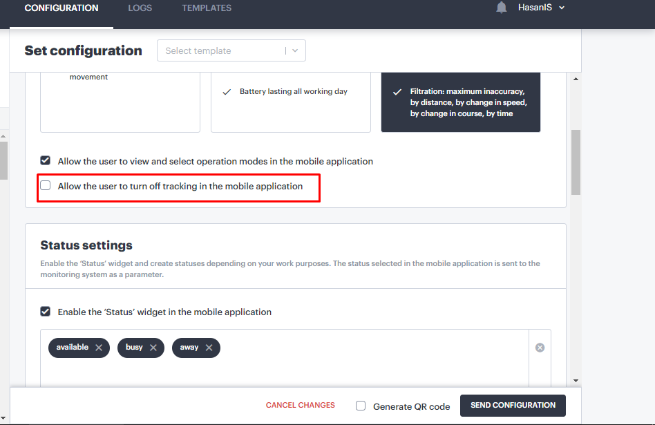

you can configure these devices remotely now, and one of the options is you can controll the holder of the wiatag and disable the ability to turn of the tracking in the app.
and if he said i want to turn it off after working hours to stop consuming charge from the phone, well you can set a working schedual

the link to configure the device is
http://configurator.telepuls.ru/config
