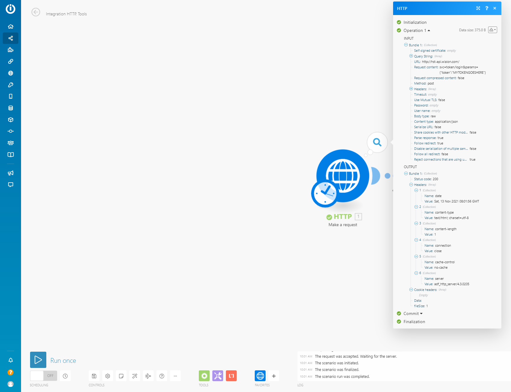

I am doing a POST request using Integromat as follows:
URL: http://hst-api.telepuls.ru/
Method: POST
Body type: RAW
Content type: JSON
Request content: svc=token/login&params={"token":"MYTOKENGOESHERE"}
What I get back is not really meaningful to be honest - See attached picture

Hello!
When you successfully execute request token/login, using POST method, the server returns JSON response where you can find session ID parameter "eid" - https://sdk.telepuls.ru/wiki/en/sidebar/ … ples/login
Also you need to use in POST
Request URL: https://hst-api.telepuls.ru/wialon/ajax.html
content-type: application/json
body-type: x-www-form-urlencoded
