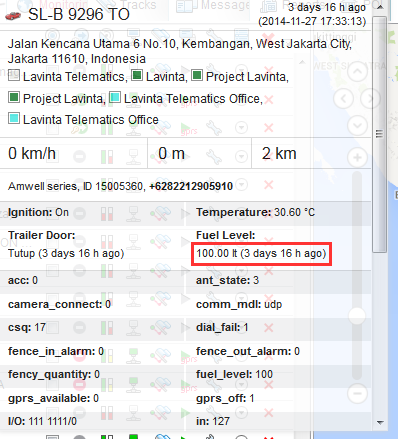

Hi Gurtam,
Could you please add new metrics from "Fuel Level" sensor type as:" %". Since amwell series giving "%" value from Fuel Level sensor as we installed. Currently the metrics only available in "gallon" & "Liter". Thanks.

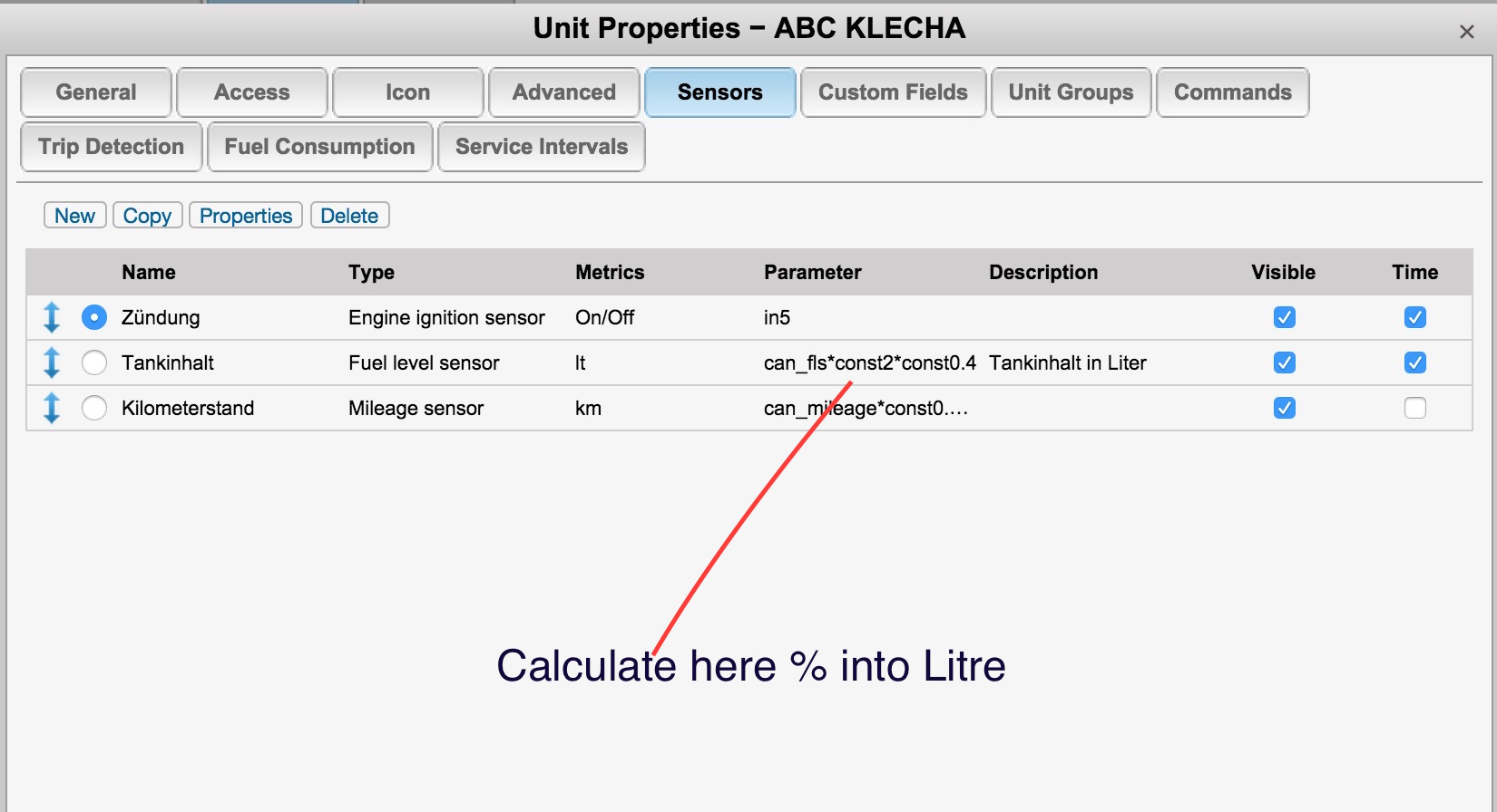

Hi Hendrian,
you can just calculate it :-)
if you receive data in % and need to know it in litres, just do some easy mathematics in the configuration of fuel level sensor (please see here a FLS of a 200 litre tank,
the formula (for our CANBUS data is) Fuel Level in Litres = Sensordata (in %) * 2 (for the 200 litres) * 0.4 (because of GPS HW calculation, a internal factor)

as i remember you can use any kind of calculation in sensors.
But only the "Fuel Level Sensor" is defined in litres.
Have a look to this:
http://docs.telepuls.ru/en/hosting/cms/u … sors/param
