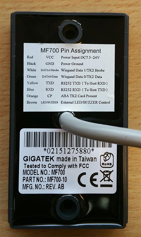

Hi All,
We have a customer who has MiFare cards, we want to use this card for driver identification.
Does anyone has experience with this sort of setup? And what reader or tracker you use?
We currently have a MF700 reader from GiGatek (see image) that can comminicate over RS232, but sofar we don't have any luck to recieve any data in wialon with this setup.
any help is appreciated! smile
Regards Dennis

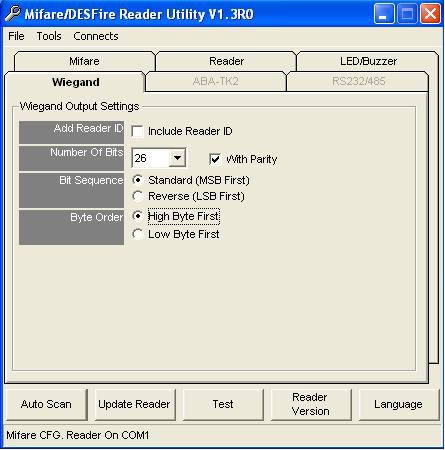

Hi Thanks,
The reader is now connected on RS232 and uses RS232 protocol, i also can setup the reader to use Wiegand.
I can setup different settings in the reader (see image).
According to teltonika they should support this reader.
  • MiFare Reader as Driver ID
