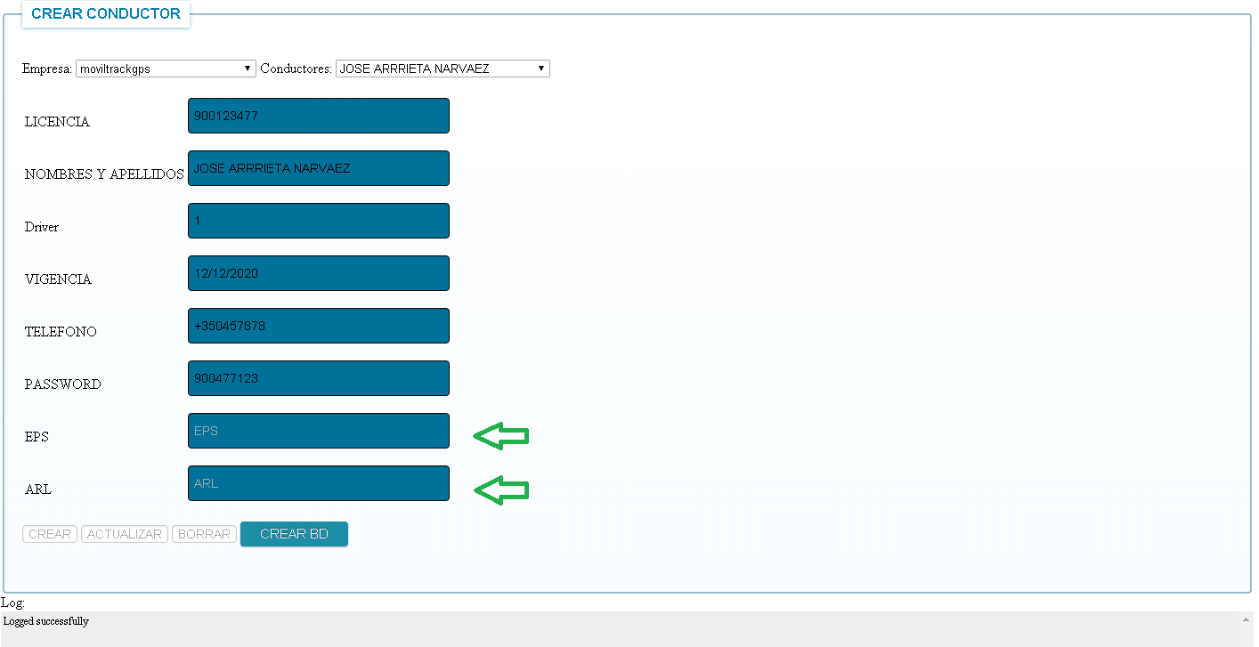

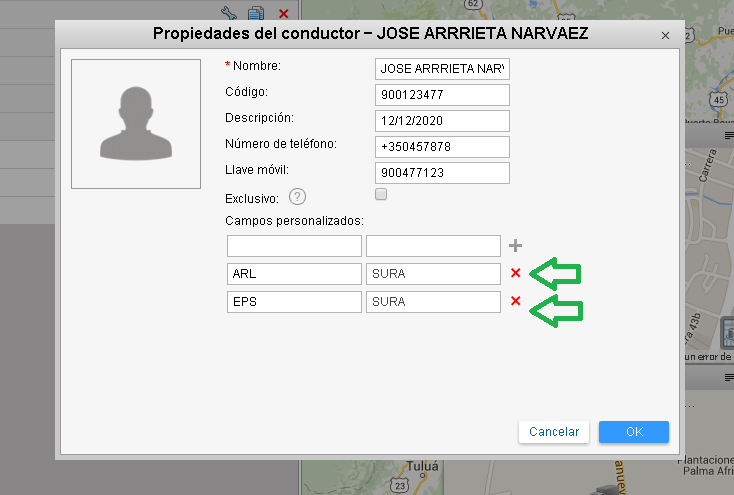

How to display custom fields drivers ?
I managed to create custom fields, but does not display the custom fields.
Attached image.

То print all drivers' custom fields You can execute such code in Your browser's console:
var resourceId = 555;
var driverId = 999;
var resource = wialon.core.Session.getInstance().getItem(resourceId);
if (resource) {
    var driver = resource.getDriver(driverId);
    if (driver && typeof driver.jp != "undefined") {
        for (var key in driver.jp) {
            console.log("driver field", key, driver.jp[key]);
