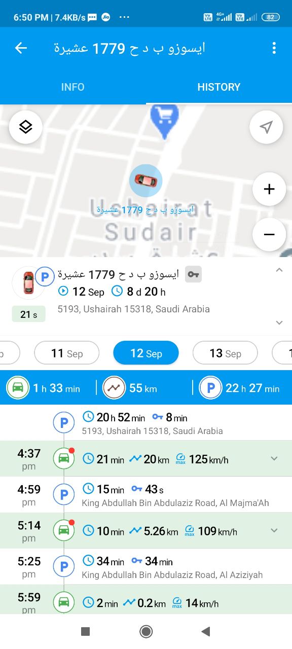

As i check to get all unit with its position i need details of the unit same as current wialon application have in their unit info and history page
i use APi
https://gps.tawasolmap.com/wialon/ajax. … p;params={
"spec":{"itemsType":"avl_unit","propName":"sys_user_creator","propValueMask":"*","sortType
":"sys_name","propType":"creatortree"},"force":1,"flags":4611686018427387903,"from":0,"to"
:1000}}],"flags":0}&sid=aa47dcb8c316d24358026924efeae7c8
what would be field that i need to use for the below perimeters https://sdk.telepuls.ru/wiki/en/local/re … ormat/unit
Unit Name items[0][nm]
Unit id items[0][id]
Unit Latitude    items[0][pos][x]
Unit Longtude    items[0][pos][y]
Speed of the car items[0][pos][s]
Engine  status
In parking or driawing
Address of the unit
image for  the unit
Engine time of the unit
which are the field says for the remain filels
