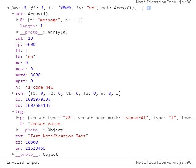

If I am trying to create the notification this way, I get "Invalid input" in the console. What should the value for sensor_type be for a custom sensor?
trg: {// Notification trigger
                t: "sensor_value",
                p: { sensor_type: "22", sensor_name_mask: "sensorA1", type: "1", lower_bound: "2.5", upper_bound: "4.5" } // trigger parameters ( geozones ids, control type)

I still can't create a notification, "Invalid input" in the console. I've changed the sensor_type to "custom" and also tried it with an empty string. I've also tried the sensor_name_mask with an empty string, but to no avail.  Below the values in the object.  What else could be wrong?
Object
act: Array(1)
0: {t: "message", p: {…}}
length: 1
__proto__: Array(0)
cdt: 10
cp: 3600
fl: 1
la: "en"
ma: 0
mast: 0
mmtd: 3600
mpst: 0
n: "js code new"
sch: {f1: 0, f2: 0, t1: 0, t2: 0, m: 0, …}
ta: 1602242951
td: 1602847751
trg:
p:
lower_bound: "2.5"
sensor_type: "custom"
type: "1"
upper_bound: "4.5"
__proto__: Object
t: "sensor_value"
__proto__: Object
txt: "Test Notification Text"
tz: 10800
un: 21523455
__proto__: Object
Create notification for custom sensors
Re: Create notification for custom sensors
Hello!
There are not correct parameters for notification
Please look after you code the request svc=resource/update_notification is send with the following parameters :
params: {"ma":0,"fl":1,"tz":10800,"la":"en","act":[{"t":"message","p":{}}],"sch":{"f1":0,"f2":0,"t1":0,"t2":0,"m":0,"y":0,"w":0},"txt":"Test Notification Text","mmtd":3600,"cdt":10,"mast":0,"mpst":0,"cp":3600,"n":"js code new","un":19294541,"ta":1602248226,"td":1602853026,"trg":{"t":"sensor_value","p":{"sensor_type":"22","sensor_name_mask":"sensorA1","type":"1","lower_bound":"2.5","upper_bound":"4.5"}},"itemId":930849,"id":0,"callMode":"create"}
The server returns the error error: 4 reason: "VALIDATE_PARAMS_ERROR"  = Invalid input ,  so some parameters are wrong
Please look the example with correct parameters below and try to compare it and use .
{"n":"sensor example","ta":1602201600,"td":0,"tz":134217728,"la":"ru","ma":0,"sch":{"f1":0,"f2":0,"t1":0,"t2":0,"m":0,"y":0,"w":0,"fl":0},"ctrl_sch":{"f1":0,"f2":0,"t1":0,"t2":0,"m":0,"y":0,"w":0,"fl":0},"un":[21728414],"trg":{"t":"sensor_value","p":{"sensor_type":"","sensor_name_mask":"*sensos1*","lower_bound":2.5,"upper_bound":3.5,"prev_msg_diff":0,"merge":1,"type":0}},"d":"","act":[{"t":"message","p":{"name":"sensor example","url":"","color":"","blink":0}}],"txt":"some text.","fl":0,"mast":0,"mpst":0,"cdt":0,"mmtd":3600,"cp":3600,"id":132,"itemId":930849,"callMode":"update"}

    window.wialon.item.Resource.dataFlag.notifications;
    let result = await new Promise((resolve, reject) => {
        sess.updateDataFlags(
           ({ type: "type", data: "avl_resource", flags: flags, mode: 1 }),
            (code) => {
                if (code) {
                    reject({ type: API_ERROR, error: code });
                    return;
                var res = sess.getItems("avl_resource");
                var mass = () //result massive
                for (var i = 0; i < res.length; i++) { // construct Select list using found resources
                    var obj = { resName: res(i).getName(), allNotif: res(i).getNotifications() }
                    mass.push(obj);
                resolve(mass);
    console.log(result);
Please advise!
Regards
Annanda
  • Create notification for custom sensors
Annanda, please look PM message
