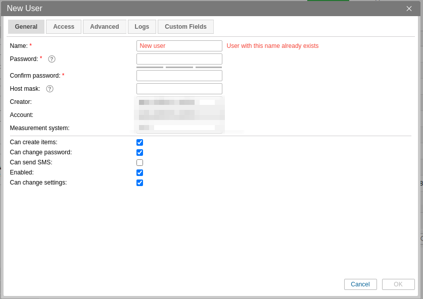

The issue we’re facing is a simple understanding of proper calculation to determine from wialon api when Change Create Item, Can Change Password, Can Send SMS, Enable, Can Change Settings are Checked (enabled) or Unchecked (disabled).
Wialon API accepts a single digit value. This value can be calculated with the sum of all user permission property value’s shown in the screenshot below.
We are not able to calculate the sum. Below is our code example that we have come up with to calculate sum:

Now the new problem is there are too many variables, how is it possible for us to determine all scenarios with this encoder/decoder?
We may end up reversing flags between 0 to 55
0x01 = 1 =    User disabled
0x02 = 2 =    Can't change password
0x04 = 4 =    Can create items
0x10 = 16 =    Can't change settings
0x20 = 32 =     Can send SMS
1+2+4+16+32 = 55
and so on the scenarios would be endless?
Based on the provided code snippet above how would you suggest we determine whether just these variables are checked or unchecked, then how we can edit just one, but not the other, and so on?
can_create_items,can_change_password,can_send_sms,enable,can_change_settings
Thank you again.
