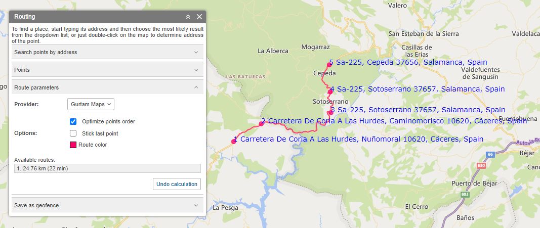

Hello,
Ive been trying to find a way to execute thruogh the Remote API, the "Routing" tool on the Wialon Hosting platform (see image below), I would like to provide the coordinates of all points in a non optimized order and get in return the optimized order and total time and distance
Routing tool throuh Remote API
The closest I got was through the comand "svc=route/optimize", but one of the parameters is a matrix with the distance in time between all points, wich I dont have, I only have coordinates, is there a way to get those distances? Or maybe another command to execute the "routing" tool?
Thanks in advance for any help,
Cheers,
Filipe

Hello Diana, thank you for your suport!
I've not been able to get it working thou, can you clarify the notation on that post you mentioned?
Also, theres no better way to optimize a set of more than two points? without having to get the distance between all them first?
Thank you again!
Filipe

Hi Filipe!
1) You can try to use  travelling salesman algorithm to get best route to visit all stated points - please look here the request notation
https://sdk.telepuls.ru/wiki/en/sidebar/ … e/optimize
2) You can use other external algorithm, like for example Google The Directions API overview - https://developers.google.com/maps/docu … s/overview
You just need to execute POST request
Request URL: https://routing-maps.telepuls.ru/hst-api … _waypoints
Form Data
data: {"origin":{"lat":40.48117173371407,"lon":-3.7986716290313143},"destination":{"lat":40.42421952957767,"lon":-3.532253172037599},"waypoints":[{"lat":40.38134294113712,"lon":-3.503414060713493},{"lat":40.32797053959649,"lon":-3.749233152476114}],"flags":0}
uid: 930848
sid: 022116d81746227638dd821bbfd41a60
where data is collection of points (coordinates)
uid - the user ID
sid - session ID
You can look an example on Wialon web-interface, tool "Routing"   via Developers Console
