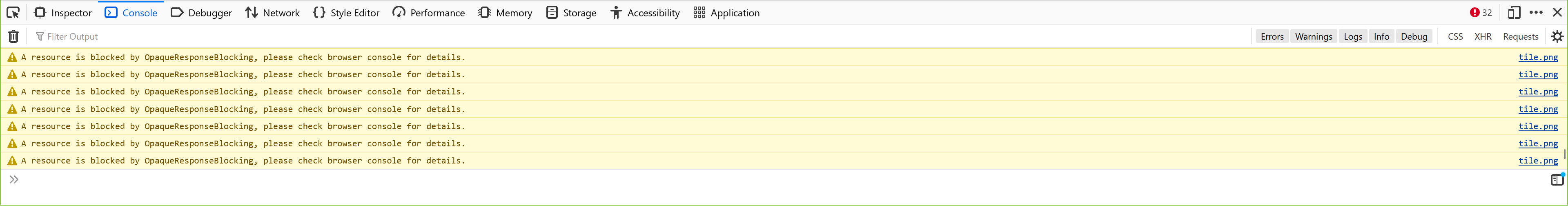

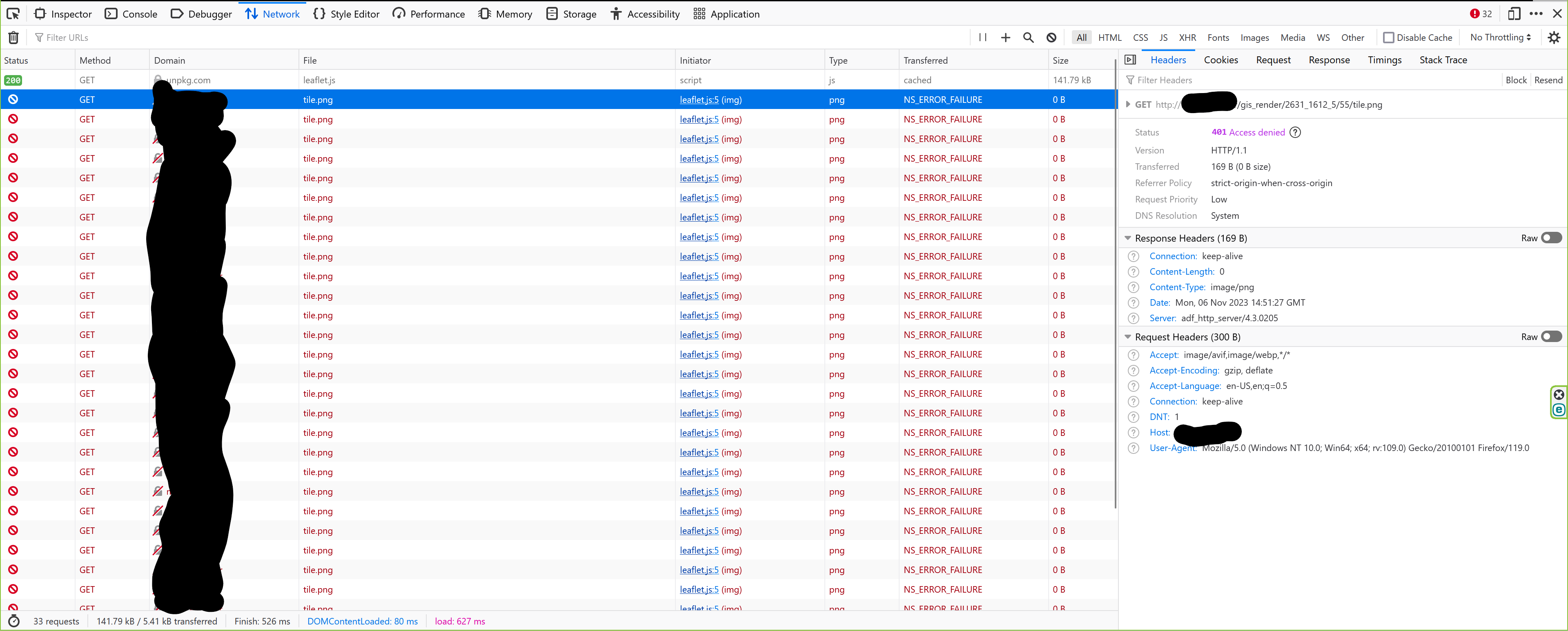

But I receive errors like screenshot.
Please let me know what is the problem.

hhamedk, hello,
Look like that the host value is incorrect. It is not possible to use just monitoring site URL.
Please, use following URL address for host:
render-maps.telepuls.ru/hst-api.telepuls.ru
The example you can find here -- https://sdk.telepuls.ru/playground/demo/gurtam_map
If you face any issues you can also create a ticket to support@gurtam.com and our specialists will handle your request.
