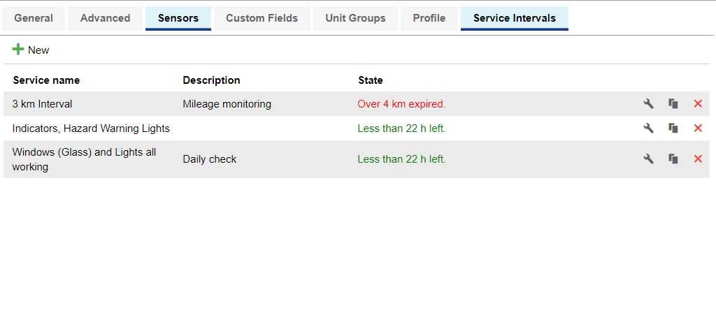

Hello everyone, I'm using JavaScript API.
I'm having problems to get the list of Service Intervals of a Unit. The thing is that I'm not sure if this is even possible using JS API, since the documentation about this is not provided.
I have tried to add the flag:
var flags = wialon.item.Item.dataFlag.base | wialon.item.Unit.dataFlag.maintenance;
But it doesn't help, i think is didn't exist. Do you know how I can get that list of Service Intervals?
I really really depreciate your help!!!
UPDATE:
There has been a while and I dont get answers. Please tell me if my question is not clear enogh? Or maybe it is just not possible?
Im also attaching an image that can help

Hello Dennise, Yes I got the anser by my own after some hours of investigation. The documention provided is not complete.
This is what I found:
1- You have to add the flags of maintenance:
var flags = wialon.item.Item.dataFlag.base | wialon.item.Unit.dataFlag.lastMessage | wialon.item.Unit.dataFlag.maintenance;
2- You need to add the library to the session:
sess.loadLibrary("unitServiceIntervals");
3- Then you have to load the intervals of one unit:
var unit = sess.getItem(UNIT-ID); // get unit by id
var servs = unit.getServiceIntervals();
4- And ready! you can do what ever you want with the list on services on "servs" variable
