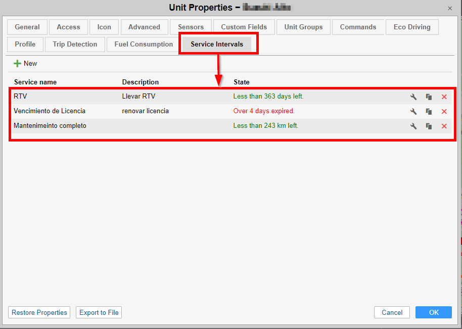

Hello everyone, I'm using JavaScript API.
I'm having problems to get the list of Service Intervals of a Unit. The thing is that I'm not sure if this is even possible using JS API, since the documentation about this is not provided.
I have tried to add the flag:
var flags = wialon.item.Item.dataFlag.base | wialon.item.Unit.dataFlag.maintenance;
But it doesn't help, i think is didn't exist. Do you know how I can get that list of Service Intervals?
I really really depreciate your help!!!
UPDATE:
There has been a while and I dont get answers. Please tell me if my question is not clear enogh? Or maybe it is just not possible?
Im also attaching an image that can help
  • Get the list of Service Intervals of a Unit.

Hello Dennise, Yes I got the anser by my own after some hours of investigation. The documention provided is not complete.
This is what I found:
1- You have to add the flags of maintenance:
var flags = wialon.item.Item.dataFlag.base | wialon.item.Unit.dataFlag.lastMessage | wialon.item.Unit.dataFlag.maintenance;
2- You need to add the library to the session:
sess.loadLibrary("unitServiceIntervals");
3- Then you have to load the intervals of one unit:
var unit = sess.getItem(UNIT-ID); // get unit by id
var servs = unit.getServiceIntervals();
4- And ready! you can do what ever you want with the list on services on "servs" variable
for(var i in servs){
    alert(servs[ i ].n); // Alert with the name
Here you can find the information of a service object:
https://sdk.telepuls.ru/wiki/en/sidebar/ … aintenance
Hope this can be useful to any other person with this question! wink
